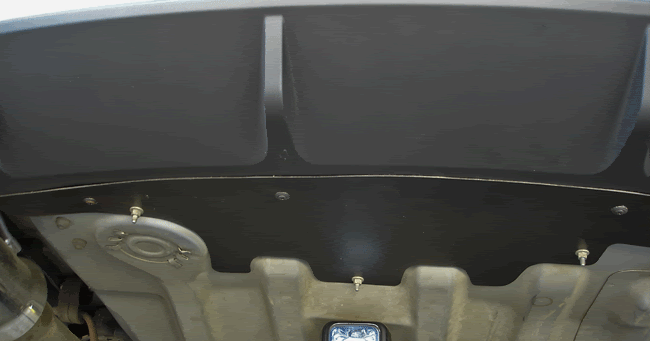

I made an aluminum panel that replaced the stock Magnum plastic panel and extends to the new Charger diffuser and attaches to the 4 tabs....

Quote:
Got any pics?

Quote:
Originally Posted by allen1013 View Post
Got any pics?
I just took a couple and will post them up shortly... Here is a shot of the panel I made...
