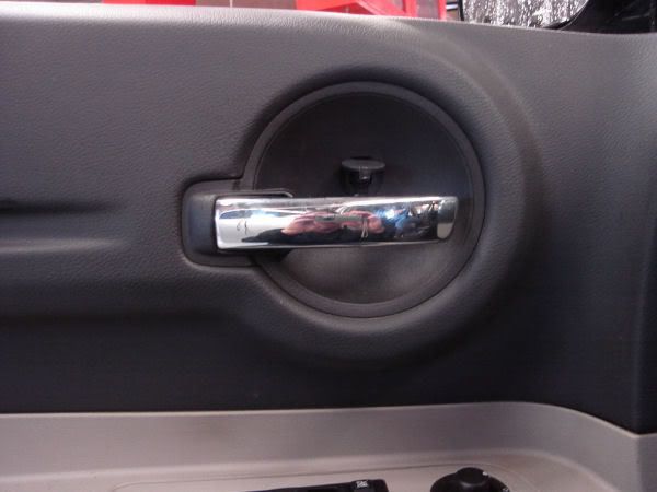

After adding a 4 channel amp, I had to run wires to the door speakers. The only problem I ran into was that the parking brake covers up the door wiring boot exit. Simple to remove 1 bolt 2 nuts. Well here we go
1) remove screw under the trap door in the door handle pocket.

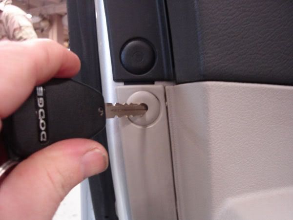

3) To remove the bottom plastic rivets (NOT BLACK), take your key and wrapping it with something soft to prevent the key from and push in(not done here for pic clarity). This way you wont push the center all the way in and have to take the weather barrier off to get them. BTW new one are $1.60 a piece if I remember right.
