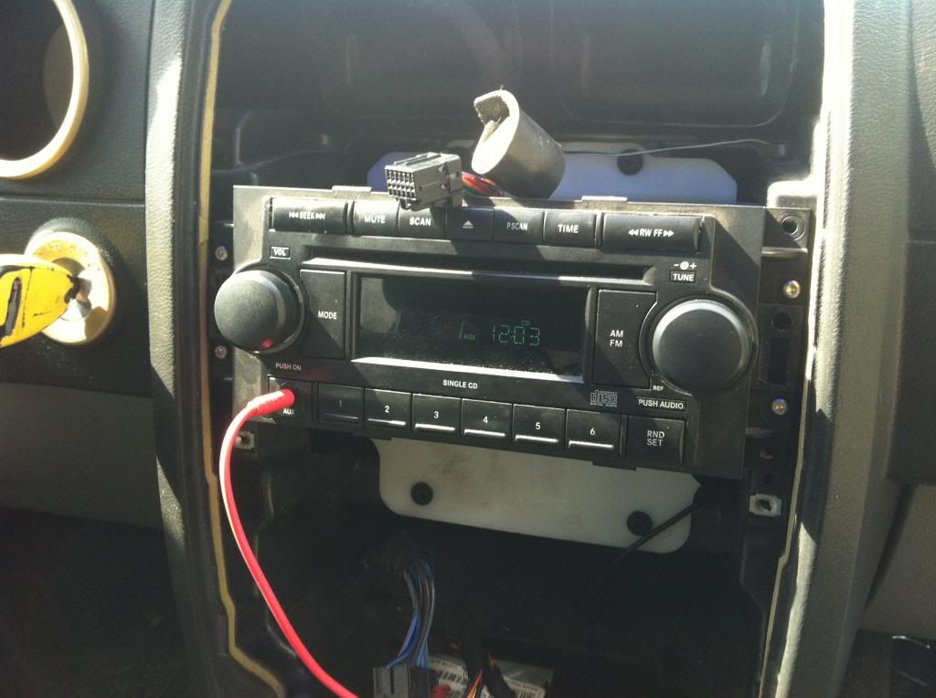

Step 1: Remove Radio Head Unit
Already dropping the ball, I did not include this step in the write up, but here's a link on how to do that because someone has already written one.
How to remove the radio *

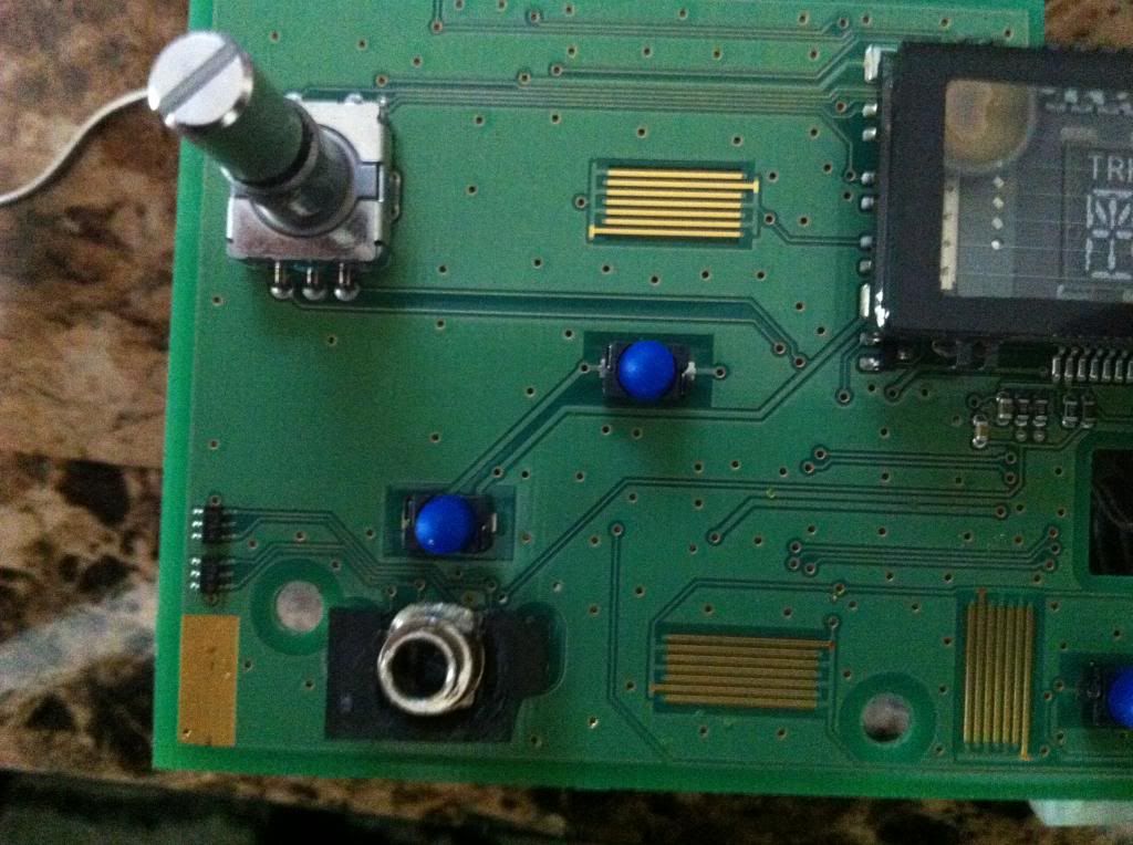

Remove Rubber Pad and Locate AUX Connection
Step 8:

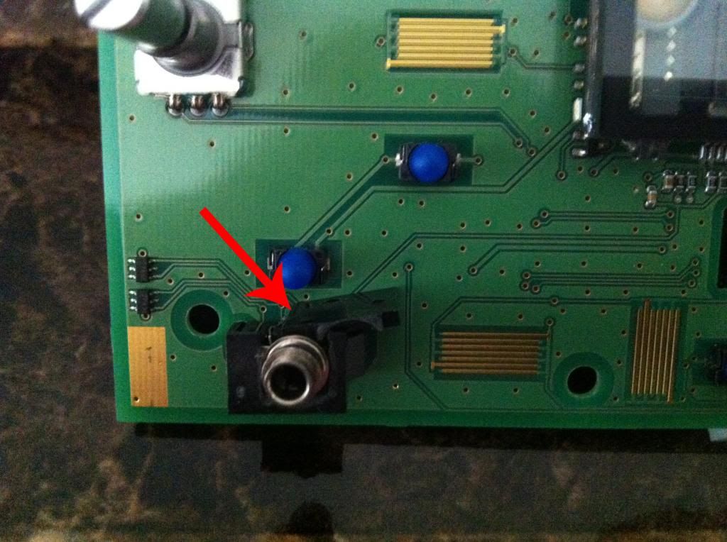

Remove "Busted Lid" off the top of the AUX Connection and set aside.
Heres where we can start to see the damage, I believe this is the main issue of the "loose-ness"
Step 9:

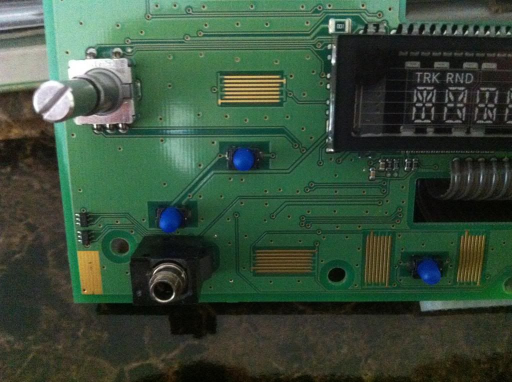

Remove AUX Receiver (Small Silver Ring) and Solder
You should now be able to view the square-circle metal plate and it will probably have a gap in it like the one pictured. You'll need to solder a bridge in the gap, after that you can add some solder to the face of the plate so you can solder the AUX Reciever to the plate
Step 10:
Replace AUX Receiver and Solder
Grab the AUX Receiver with the pliers and hold it in place while you heat it up with the soldering iron, this should melt the Soldering metal underneath it, connecting the AUX Receiver to the square-circle plate

Glue "Busted Lid" Back on
I dont know another way to do this, I used Epoxy, but super glue should work just as well, if anyone could improve this step, please chime in. Like I said, this seems to be the main brunt of the issue. (Sorry for the bad pic)
