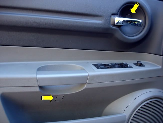

There are 7 screws that need to be removed from the door panel two under these covers and 5 along the lower edge. The covers can be a little tough to open without scratching the door panel ,so be careful...
