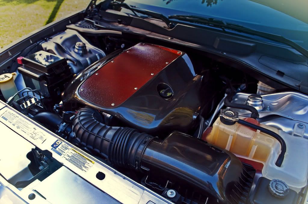

This is how my intake looks... other than the upgraded SRT airbiox, it looks completely stock.
