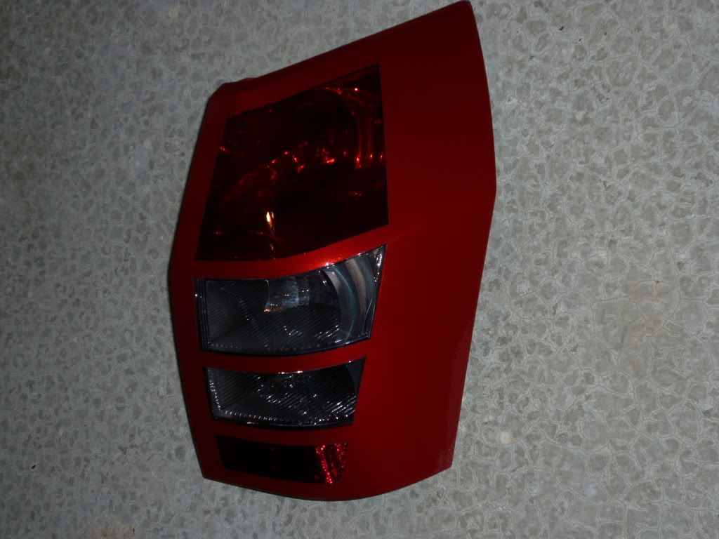

I'm finished with the primer, base, and clear now all that's left is to wait about 3 or 4 days before wet sanding, buffing, and polishing. Can't see in the shots but there are a couple runs that need to be taken care of. What does everyone think of them so far? Lemme know...I can handle it!!

Thoze R BAD AZZ BRO,if U ever get tired of em or juzt want to get rid of em-U definitely got ME to consider!!!!!
Congratz!!!!!

I think they look bad ass steve! as long as you give that clear a full day to dry at normal temps, you don't need to wait 4 days to buff them out either

those look great Steve!!

How did you make the lines so sharp steve??? they look great!

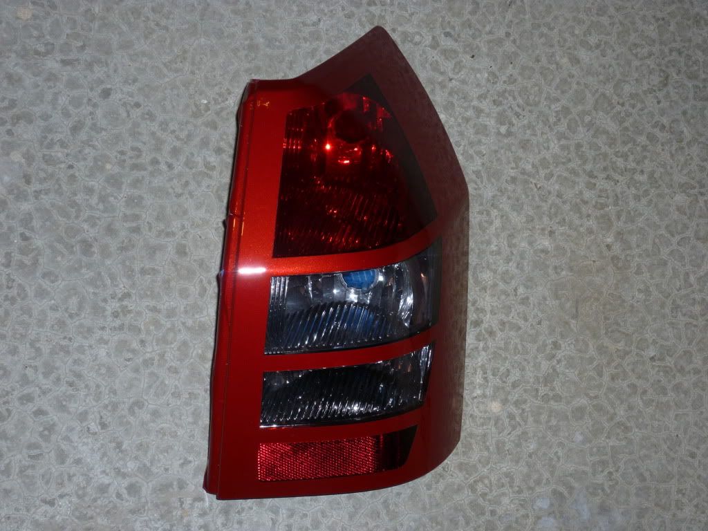

Thanks guys but I didn't do anything special with 'em. I just used regular painter's tape. Here's a shot before I taped off the bottom reflector:

Nope. No blades involved. I just gradually curved the tape as I was laying it down. For the curves at the top inside corners I used two straight pieces and then cut the curve into another piece of tape with scissors.
