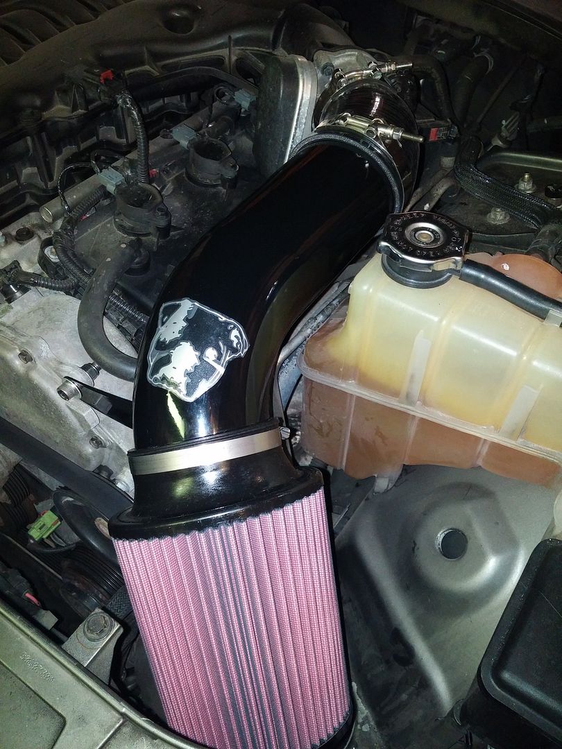

Finally got the Big Bully intake I wanted.
Sorry for the dirty engine pictures. Raining last night and with my intake broke I wanted it in right away.
I had a lot of fun removing and inserting the air temp sensor. Ended up putting a socket over it to push it out and a chunk of cardboard over the connecter to get it into the new intake. Waiting on a tank to be used up before I go from the stock tune back to the Diablo tune. :049:

Back to the 93 oct tune. Very nice with the Big Bully. I feel like there is a difference, especially kicking it in while passing another car. Whoot!
