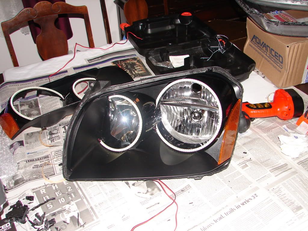

OK so I got my AAC LED halos today and as soon as I got home from work it was time to install!! AAC already has good walkthroughs on how to open the headlights but I found a way that worked better for me on re sealing them!!!
Step 1:
Go to your local auto parts store and get some of this make sure it has that white nozzel it helps a bunch. And get at least 2 tubes one for each light.
Step 2:
After installing you halos you are ready to re seal the lights!!! You will need some painters tape or electrical tape and the sealant open the sealant and cut off the tip of the white nozzel to the desired size... run a good bead all the way around the ridge of the backing WITH the bezel in place it has tabs that rest in the backing
Step 3:
After running the bead of sealant all the way around it's time to put the lens on... Line it up and press it on... take the tape and attach it to hold the lens in place
Step 4:
take the tube of sealant again and run it around the edge to make sure you don't have any holes!!!
and then you wait... You can use your fingers to smooth out the sealant but forwarning it will stain your fingers... so wear some latex gloves.
the sealant says 1 hour to firm but 24 to full cure and max strength!!!
GOOD LUCK EVERYONE!!!!
