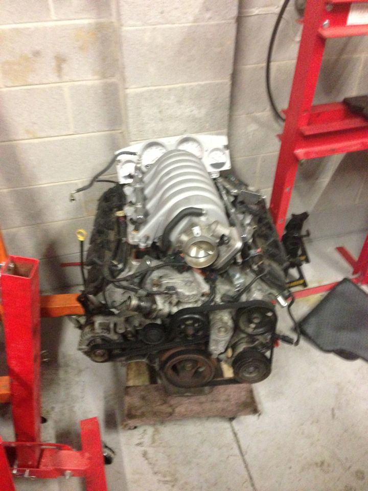

Yes, just like the title says.. I'm building a AWD SRT Magnum! Let's get down to business..
Parts list
6.1 Engine
SRT Gauges
6.1 PWR Stage 2 Cam
JBA Shorty Headers
New Water Pump
New Timing set
New Motor Mounts
Exhaust manifold 18 bolts 6.1 LITER
Intake manifold gasket 6.1 LITER
Intake manifold seal 6.1 LITER
Base gasket 6.1 LITER
Tensioner screw 5.7 & 6.1 LITER
Tensioner 5.7 & 6.1 LITER, 6.1 liter
Serpentine belt 5.7 & 6.1 LITER, 6.1 liter
Idler pulley cap 5.7 & 6.1 LITER
Idler pulley 5.7 & 6.1 LITER
Timing cover gasket 6.1 LITER
This should be fun.. I'll keep ya posted!

Gonna be sweet! Make sure to buy a few extra transfer cases and sets of front axles. Not sure what kind of torque that front unit can reliably handle. If you have a 6.1, unless you're going with long tubes, stay with the OEM SRT headers. They're going to be better on the 6.1 than JBA shorties. Don't forget to refresh the heads with new springs, etc.

The shop recommended longtubes or JBA shortys, and I can't run longtubes unless I buy a $500 transmission brace. The guy who makes the brace told me 300 than changed it to 500, and that made me go shorty..

If you have access to a dealer scanner you can just reprogram the 5.7 AWD PCM to be a 6.1 AWD PCM. Only way to do it.
#9 ·
Well if its an awd 6.1 pcm maybe ull need the jeeps pcm???
#10 ·
Nope, just take the 5.7 PCM and program it for a 6.1. Do need a starscan or wytech to do that though.

Just the PCM with a starscan should do it. There is nothing different about the rest of the drivetrain that should substantially prohibit you from doing a block swap. Tranny, diffs and t-case will hlod up if you don't flog the snot out of it off the line. You will probablly be able to reuse the oil pan off you 5.7 without issue. Looking forward to seeing this, good luck!

yes sir , it was a 5.7 rt awd , the guy i bought it from bought it with a blown up engine , he had a bout a dozen older muscle cars and thought this would be a great project , his mechanic is a wyo tec grad and new a dyno shop with a 6.1 engine sitting around , they bought it and did the swap , they told me the only thing they had to do was to install a diablo tuner as the 6.1 does not have the multi displacement system , so the diablo turnes that of in the car .... they said other than that most of the swap was pretty straight forward ... they found the front and rear seats from a srt and the gauges , the car already had alot of work done to it so i have only added the wheels and painted some of the black mouldings one the car ...

Yes srt headers will fit, and longtubes will fit with an added trans brace. The 18 bolts are to replace the bolts that come with the new headers.
I don't know the weight difference, if any. A lot of the suspension and trans-case will be custom.
